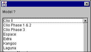

Model
Select Model from the identification form, a dialog box
will appear:
Then select the model from the list and click on the OK
button. This information will be inserted in the
identification form.

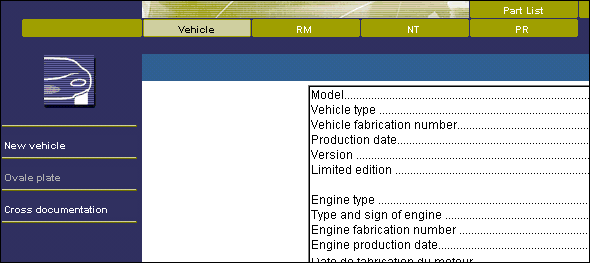

Identification form with the completed information:
Status bar
You will find the principal specifications of the vehicle (model,
vehicle type and production number) on the top right of the identification
form:
